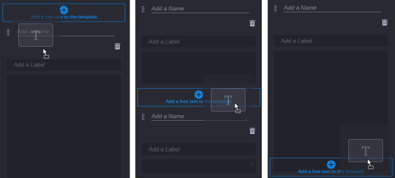

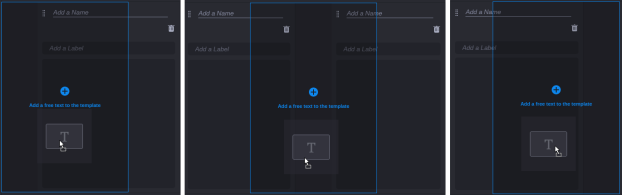

You add and move components into what are called drop zones on the template. There are five drop zones: top, bottom, left, right, and center (vertically between two components; horizontally between two components within a column). Each drop zone is highlighted in blue to help you identify where the component will be positioned within the template when you release the mouse button. When adding components to a template, drop zones are shown as dimmed rectangles, when moving components within a template as solid bars.
The following illustration shows left, center, and right drop zones (left to right) when adding components.
The following illustration shows top, center, and bottom drop zones (left to right) when adding components.
