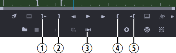

The following illustration shows the buttons in the Media Viewer that you use with In and Out points.
                                                         1  |
                                                         Go to In  |
                                                         4  |
                                                         Mark Out  |
                                                         2  |
                                                         Mark In  |
                                                         5  |
                                                         Go to Out  |
                                                         3  |
                                                         Play In to Out  |
