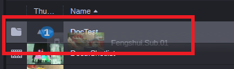

During the drag and drop operation, a number appears in the upper-left corner of the drag window that indicates the number of items that are being affected.
Note the following when dropping into the Results area:
  • Dropping on a folder name in the Results area highlights the folder. Your selection is copied/moved to the sub-folder of the folder currently being open in the Results area.
  • Dropping on any other region of the Results area highlights the entire Results area as drop target (highlighted with a blue frame). Your selection is copied/moved to the folder currently being open in the Results area.
