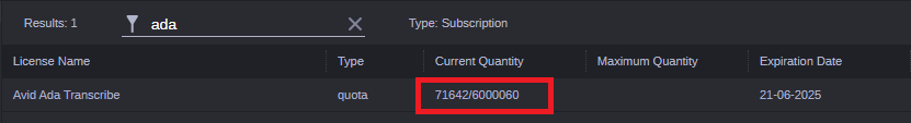

  3. Do one of the following:
    • Scroll down the License app's Results area to the Avid Ada Transcribe license.
    • Type "avid a" in the Filter Licenses field in the Results area toolbar.
  4. Check the Current Quantity.
    For Transcribe, the number on the left indicates how many minutes have already been consumed and the number on the right indicates the total number of minutes that can be transcribed within a cycle.
