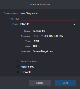

  2. Click the Quick Send button in the Asset Editor and select the Send to Playback option.
    A Send to Playback window appears.
    The name of the sequence or individual asset that you are sending to playback is displayed to the right of the Name field.

  3. Review the following fields and options to configure your Send to Playback job:
    1. If necessary, enter a Video ID for the job.
      A VideoID is a unique identifier for the asset that is being sent to the playback device. Depending on your workflow, you might be required to follow a strict naming convention when assigning VideoIDs, or you might decide to assign an arbitrary name or number such as “stp01” or “1234”. In any case, you must associate a VideoID with each Send To Playback job. You can populate this field using one of the following methods:
      • If you opened the sequence through the Rundown app, the Video ID is populated with the Video ID that is assigned to the story.
      • If you used an editor like Avid Media Composer to associate a Tape ID with the sequence, the Tape ID is used as the Video ID.
      • Manually through the Quick Send > STP window.
      If a Video ID is already associated with the asset, the ID is added to the profile automatically and the field cannot be altered. If you send a sequence to playback and you assign a VideoID manually, the ID is saved in the sequence metadata when the job is initiated.
      n Valid characters for the VideoID field are alphanumeric characters, hyphen, and underscore. You cannot type invalid characters in the VideoID field. If you attempt to copy/paste text that includes invalid characters into the VideoID field, the characters are removed during the paste process.
      n The VideoID field’s maximum character length can vary between different broadcast playout devices and control systems. Check with your local administrator before assigning a VideoID.
    2. Click the arrow on the right side of the Profile field and select an option from the menu.
      After you select an option from the menu, the associated fields are populated according to the settings assigned to the profile.
      Send to Playback profiles are configured by your system administrator. For more information, see “Using the Configuration Settings App” in the Avid MediaCentral | Cloud UX Installation Guide.
    3. (Optional) If your MediaCentral Cloud UX system is integrated with a graphics management system, and you are sending a sequence to playback that includes timed graphic elements, you can enable the Burn Graphics check box to embed or “burn-in” the graphics into the video stream. When the asset reaches your destination, the media includes a flattened track of graphics and video.
      If your system is not integrated with a graphics management system, you are sending an individual master clip to playback, or your sequence does not include any timed graphic elements, the Burn Graphics option is grayed-out. For more information on timed graphics, see Adding Graphics to a Story Sequence.
    4. (Optional) Select High Priority if you need the sequence to be transferred as quickly as possible to the playback device.
      This check box should only be used in rare circumstances where the playback job must happen as soon as possible. Overuse of this feature by multiple users can decrease its effectiveness..
    5. (Optional) Select Overwrite if you want to automatically overwrite any sequence with the same VideoID already sent to the playback device.
      If you attempt to send an asset that has the same VideoID as an existing asset on the playback device, you receive an error message indicating that the job cannot be completed. Select the Overwrite option only if you are sure that you want to overwrite an asset with the same VideoID.
  4. Finally, click the Send button to initiate the job.
