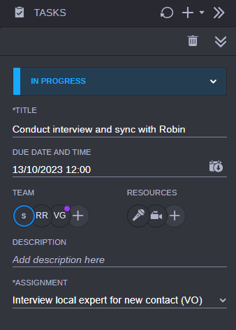

Complete the following process to create a new task. After creating a task, you can use the Tasks panel to access the task and edit the title, status, or other values.

  2. (optional) Click the Status menu below the task title and assign a new status.
    Each new task is associated with the New status by default.
  3. Click the title area and enter a new name for the task.
    As you type, a character counter appears below the field. Your title can contain up to 200 characters.
  4. (optional) Enter a Due date and time to define the completion date for the task.
    After you assign a Due date, you can click the Download button to save the task as a calendar entry. For more information, see Exporting to a Calendar.
  5. (optional) Click the Team button and assign one or more users to the task.
    The app displays the five most recently used value for each of these menus. Alternatively, you can click the Show All button to display additional values.
    If the user has the Collaborate app installed on their mobile device, they will receive a notification that they have been added to the task.
  6. (optional) Click the Resources button and assign resources to the task. Similar to the Team button, the Resources button might display either the fast menu, or a complete Resources menu.
  7. (optional) Enter text in the Description field to provide more information about the task.
    Similar to topics and assignments, Collaborate allows you to add not only text, but also (web) links into this field.
  8. (optional) Reassign the task to a new assignment.
    When you create a task, Collaborate associates it with your current assignment by default. The Assignment menu allows you to move the task to a different assignment. This feature can be useful if the scope of the assignment or task changes, or if you've completed the task and want to reuse it in a different assignment.
