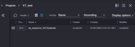

The following illustration shows a folder where a sequence is saved, but with the referenced assets setting disabled. Only the sequence that has been saved is displayed inside the folder.

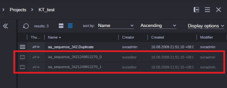

The next illustration shows the same folder where the sequence is saved, but this time with the referenced assets setting enabled. As the sequence is composed of two master clips saved in different folders, you will be able to see those as well. The master clips are greyed out to indicate that they are referenced assets.
