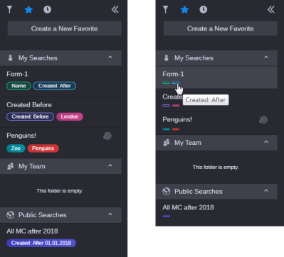

As shown in the following illustration, favorites are divided into three categories:
  • Personal: Appearing in the list under the My Searches category, personal searches are created by individual users and they are not included in the list of Favorites for any other user.
  • Team: Favorites created within a team are shared with specific user groups. The creator of the team can allow all users to contribute to the team, or restrict access by configuring the team for read-only access. You must be a MediaCentral Cloud UX administrator to create Team favorites.
  • Public: Created by an administrator, public searches are available to all users that are connected to the same MediaCentral Cloud UX system. If your system is included in a multi-site environment, the public favorite appears only to users connected to your local site.
Favorites are displayed in a list view with each of the search terms displayed. Personal favorites appear first in the list under the My Searches area, followed by search teams (if applicable), and then public searches.
The following illustration shows a side-by-side comparison of the same favorites. The image on the left shows the standard view while the image on the right shows the collapsed view. The ability to collapse the list allows you to show more favorites on screen at the same time. If you place your cursor over any of the search pills within the favorite, a tool-tip appears that describes the pill. For more information, see Collapsing the Favorites List.
