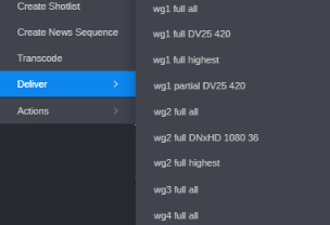

  2. Do one of the following:
    • Click the App Menu button and select Deliver > [profile].
    • Right-click and select Deliver > [profile].

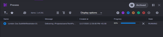

    For each asset, a job is submitted. You can view the status of the delivery in the Process app, job group Delivery.
    To cancel the job, click the X (Cancel) button. To restart a canceled or failed job, click the Retry button.
    If the job was successful, the media and metadata asset are transferred to the destination workgroup, as defined by the profile you used for the Delivery job. The job message displays the source asset’s path and the used delivery profile followed by the asset path on the target system.
