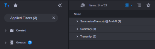

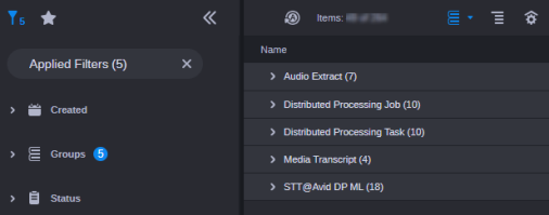

  3. To show only transcribe jobs using "Groups":

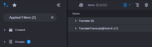

    1. Expand the Groups list in the Filters sidebar.
    2. Click the "show all" button.
    3. In the break-out window that opens, select the process groups you want to display and then click the Apply button.
      • For Transcribe: Audio Extract, Distributed Processing Job, Distributed Processing Task, Media Transcript, STT@Avid DP ML
      • For Translate: TranslateTranscript@Avid AI and Translate
      • For Summarize: SummarizeTranscript@Avid AI and Summary

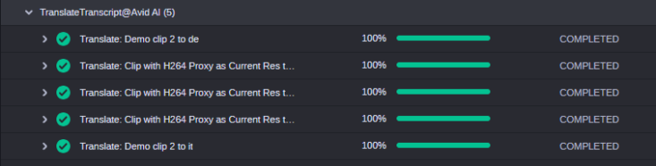

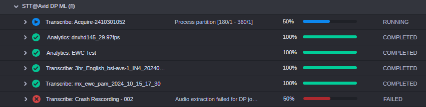

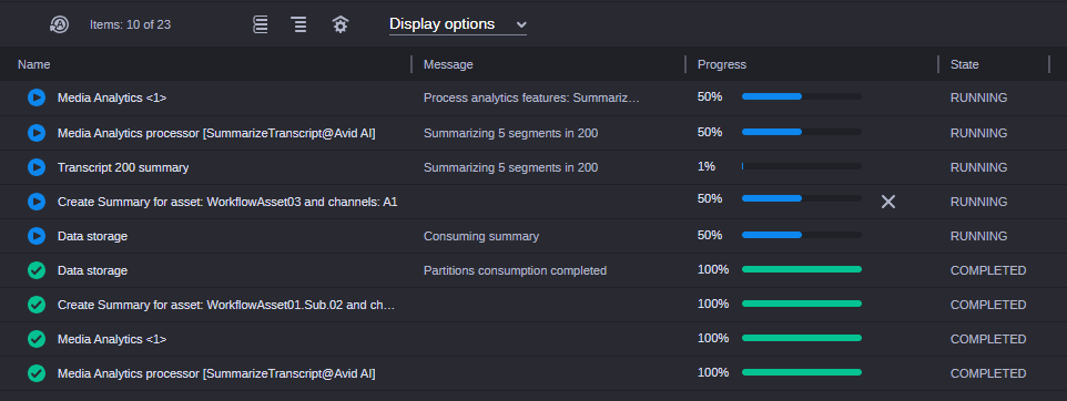

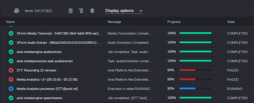

    The Process app shows you only the corresponding jobs. Example for transcribe jobs:
    Example for translate jobs:

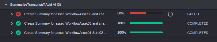

    Example for summarize jobs:
  4. To define the grouping behavior:
    1. Click the Display Group button so it turns blue.
      Jobs are grouped by the group property in the Process List.
      Example for transcribe groups:

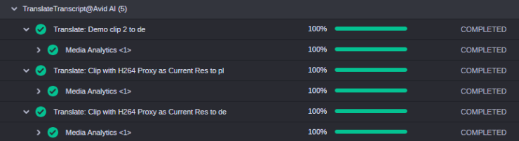

      Example for translate groups:
      Example for summarize groups:

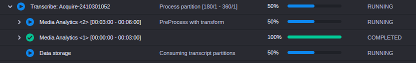

  5. To visualize the job hierarchy for Transcribe:
    1. Click the Show Hierarchy button in the Process app toolbar so it turns blue.
      Sub-jobs are arranged below their parent job in the Process List.
      Since the Groups filter is still applied and Transcribe jobs are parent jobs, the names of the other involved Groups are no longer shown.

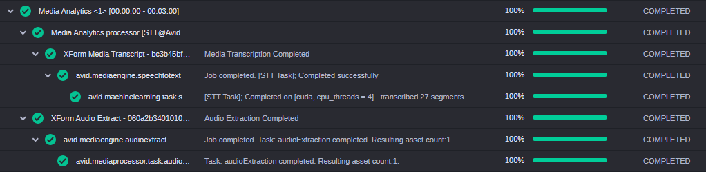

    1. Click the Expand button to the left side of the STT@Avid DP ML group header to show all top-level Transcribe jobs.
      Each top-level Transcribe job shows the name of the asset for which the transcript is currently being created and a prefix (such as Transcribe or Avid DP ML Transcribe) in its name.

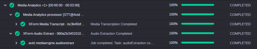

    1. Click the Expand / Collapse toggle button in front of a top-level Transcribe job to show or hide its sub-jobs.
      On the second hierarchy level, a Media Analytics<number> job for each partition is shown.
      • For EWC clips, the partition size is 3 minutes.
      • For non-growing clips, the partition size is 1 hour.
      Below each Media Analytics partition job, the involved Audio Extract, Media Transform, Distributed Processing Job and Distributed Processing Task jobs are shown.
    2. Click the Expand / Collapse toggle button in front of a parent job to show or hide its sub-jobs.

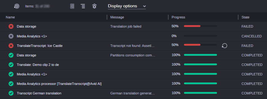

  6. To visualize the job hierarchy for Translate:
      Since the Groups filter is still applied and Translate jobs are parent jobs, the names of the other involved Groups are no longer shown.

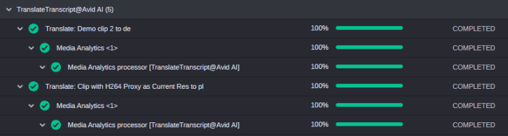

    1. Click the Expand button to the left side of the TranslateTranscript group header to show all top-level Translate jobs.
      Each top-level Translate job shows the name of the asset for which the transcript translation is currently being created and a prefix (such as Translate or Avid AI Translation) in its name.
    1. Click the Expand / Collapse toggle button in front of a top-level Translate job to show or hide its sub-jobs.
      Below each Media Analytics partition job, the involved Media Analytics processor jobs are shown.

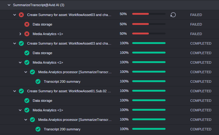

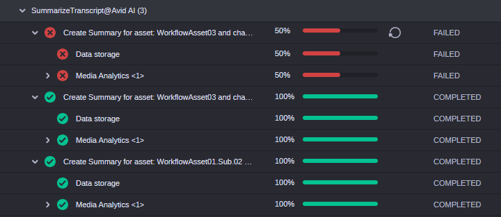

  7. To visualize the job hierarchy for Summarize:
      Since the Groups filter is still applied and Summarize jobs are parent jobs, the names of the other involved Groups are no longer shown.
    1. Click the Expand button to the left side of the SummarizeTranscript group header to show all top-level Summarize jobs.
      Each top-level Summarize job shows the name of the asset for which the transcript summary is currently being created and a prefix (Create Summary for asset: <name> and channels: <audio track>) in its name.
    1. Click the Expand / Collapse toggle button in front of a top-level Summarize job to show or hide its sub-jobs.
