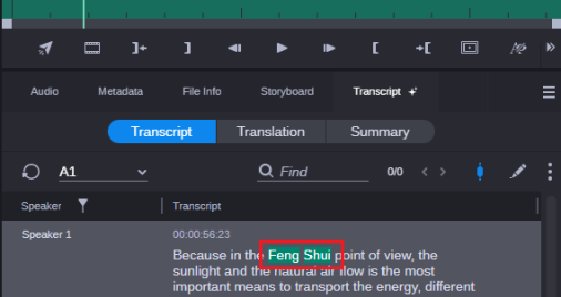

  • If the Sync Playhead toggle button is selected (blue button, default), during playback in the Asset Editor's Media Viewer or when you position the playhead in the timeline, the corresponding word is highlighted in green in the Transcript area.
    Vice versa, when you select a section in the Transcript area, the playhead in the Asset Editor's Media Viewer is positioned to the corresponding timecode.
  • If the Sync Playhead toggle button is deselected (gray), during playback in the Asset Editor's Media Viewer, corresponding words are not highlighted in the Transcript area. Selecting a word in the Transcript area does not move the playhead in the Asset Editor's Media Viewer.
  • When you enable the Edit Mode button to edit the transcript, Sync Playhead is deactivated.
To navigate the transcript:
  1. Open an asset in the Asset Editor.
  2. Open the Transcript tab.
    The Transcript tab opens in Transcript mode.
  3. (optional) Click the Orientation menu in the Asset Editor toolbar and select the dual column view.
  4. Select a transcript which you want to view from the transcript selection control.
  5. To navigate with enabled synchronization:
    1. (if inactive) Activate the Sync Playhead button.
    2. Start playback or move the playhead in the timeline.
      • The currently spoken word is highlighted in green in the Transcript area, its segment is highlighted in gray. While playback continues, playhead and highlighting update in tandem, the Transcript area scrolls down the list of transcript segments.
      • When the position is between two words, the left word in the Transcript tab is highlighted.
      • When two words share the same timecode, both words are highlighted in green in the Transcript tab.
      • When the position is between two segments (gap), the left segment is highlighted in the Transcript tab.
    3. Click on a segment in the Transcript tab.
      The first word is highlighted in green and the playhead is moved to the corresponding timecode in the timeline.
    4. Click on a word in the Transcript tab.
      The word is highlighted in light green and the playhead is moved to the corresponding timecode in the timeline.
