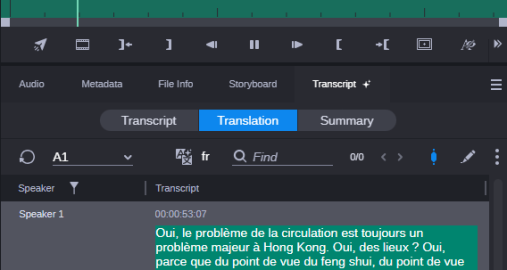

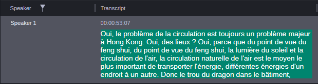

  • If the Sync Playhead toggle button is selected (blue button, default), during playback in the Asset Editor's Media Viewer or when you position the playhead in the timeline, the segment that contains the corresponding word is highlighted in green in the Translation area.
    Vice versa, when you select a segment in the Translation area, the playhead in the Asset Editor's Media Viewer is positioned to the start timecode of the segment.

  3. Click the Translation button to switch to Translation mode.
  4. (optional) Click the Orientation menu in the Asset Editor toolbar and select the dual column view.
  5. Select a transcript from the transcript selection control.
  6. Select the translation which you want to view from the translation selection control.
  7. To navigate with enabled synchronization:
    1. (if inactive) Activate the Sync Playhead button.
    2. Start playback or move the playhead in the timeline.
      • The segment that contains the currently spoken word is highlighted in green in the Translation area. While playback continues, playhead and highlighting update in tandem, the Translation area scrolls down the list of translation segments.
      • When the position is between two segments (gap), the left segment is highlighted in the Transcript tab.
    3. Click on a segment in the Transcript tab.
      The entire segment is highlighted in green and the playhead is moved to the start timecode of the segment in the timeline.
