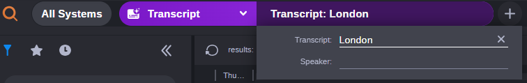

For example if you select the Transcript option under the simple category, you are presented with a single-value field.
If you select the Transcript search type from the advanced section, you are presented with menu that allows you to enter one or more values to further narrow your search.
If you enter 2 or more values in an advanced pill, you are essentially creating a compound search. Values that are included in the pill must be found in the same marker, segment, or layer. For example consider a transcript that has two speakers and the phrase "Avid". If you search for Speaker 1 and Avid, the search would return a hit only if Speaker 1 says "Avid". It would not return a hit if Speaker 2 says "Avid".
