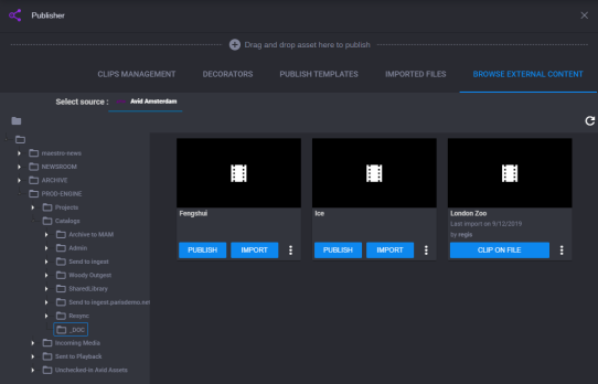

Browse External Content - This is a connection to Production Management or Asset Management, allowing you to browse the Production Management or Asset Management system and quickly publish or save (upload to the SAAS server) a file.

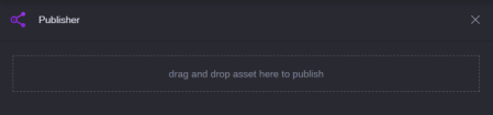

Drag a video clip or image from the Browse app or video player directly to the Publisher app header area where it says “drag and drop assets here to publish”.
After you drag an asset into the Publisher app header, the text turns blue and says “Drop asset here to publish”.

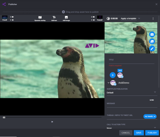

Release the mouse button. A representative video frame appears in the Publisher video player, and in the Clip Details area as shown below:
Select a file from the Browse External Content tab. This is a connection to the Production Management or Asset Management system, allowing you to browse the Production Management or Asset Management system and quickly publish or save (upload to the SAAS server) a file.

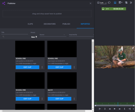

For media that is outside of the Production Management or Asset Management environment (e.g., Windows Explorer, etc.), click the Imported files tab, and drag and drop files (videos, images, subtitles) from your local system to the down arrow where it says “Drop local files here”.
n The arrow will turn blue when the file is held over it.
When you release the mouse button, the file will appear below.
You can drag multiple files to this area, and then import or publish them at once.
n When importing a video this way, if there is an SRT file next to the video (and it has the same name), you can import both the video and the SRT file by selecting and uploading both the video and the SRT file.
