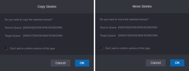

    MediaCentral Cloud UX displays a message asking you to confirm the move or copy operation.
  4. Click OK to complete the operation or Cancel to leave the queue unmodified. For each key-locked story in your selection, you need to provide your password in a separate dialog.

    MediaCentral Cloud UX displays a message asking you to confirm the move or copy operation. Click OK to complete the operation or Cancel to leave the queue unmodified. For each key-locked story in your selection, you need to provide your password in a separate dialog.

    MediaCentral Cloud UX displays a message asking you to confirm the copy operation.
  4. Click OK to complete the copy or Cancel to leave the queue unmodified. For each key-locked story in your selection, you need to provide your password in a separate dialog.
