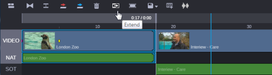

The following illustration shows a selected segment (video plus NAT) in the first timing block. The position indicator is at the 25 second mark, which is the location to which you want to extend the segment. The tool-tip for the Extend/Retract button displays “Extend.”

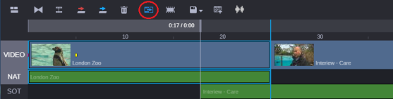

After you click the Extend/Retract button, the video and NAT for the selected segment extend to the position indicator. The Extend/Retract button turns blue as shown in the following illustration.
Its tool-tip also changes to “Retract,” (not shown). The blue icon (circled in red) indicates that the selected segment is extended. You can remove the segment extension by clicking the Extract/Retract button to retract the segment.
