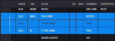

You can group stories within a queue to link them together. For example, a producer might want to link a presenter’s intro and tag before and after a reporter’s package as a story group within a rundown. When stories in a queue can be grouped, a Story Group column appears as the second column in the Queue section located next to first column of selector buttons.
n You can only create groups from contiguous stories.
The following illustration shows selected stories in a story group.
