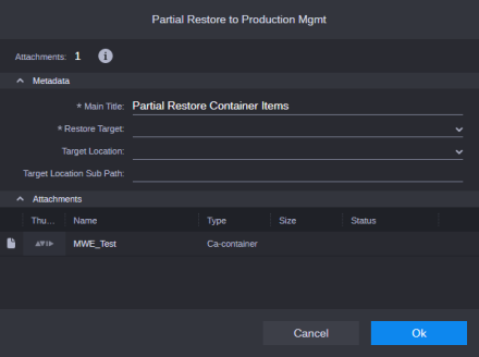

  1. Right-click either an individual asset or an area of empty space in the Media container, and in the context-menu that opens select Container Actions > [Asset Management / Shared Library system to run the process] > Partial Restore to Production Mgmt.
    The Partial Restore to Production Mgmt process creation template opens.
  2. Provide a main title for the process. If you do not provide a title, the default title “Partial Restore Container Items” is shown as process title in the Process app.
  3. Select the restore target to be used from the Restore Target list (unless customized, only “Standard” is provided).
  4. (optional) Select the target location to be used from the Target Location list.
  5. (optional) Provide a target location sub path. You can use / as a separator for sub directories.
  6. Click OK.
    The Restore process is triggered for the assets in the container.
