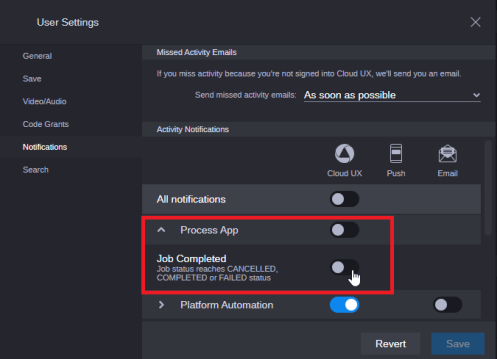

To customize your notification options:
  1. Click the User Profile button on the right side of the Fast Bar and select User Settings.
    The User Settings dialog box opens.
  2. In the navigation panel on the left, select the Notifications group.
  3. In the Activity Notifications section, go to the Process app group and do one of the following:
    • Click the toggle in the app’s header so it turns blue.
    • Click the toggle of the Job Completed feature so it turns blue.
  4. Click the Save button.

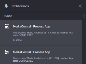

    Next time you trigger a transcribe job, the Process app sends a notification once the job has reached a final state, as shown in the following example.
  5. (optional) Click on a notification.
    The Process app opens. Note that the corresponding process will not be highlighted in the Process app.
