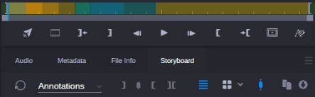

Use the layer selector control to open a stratum in the Storyboard tab and show and edit its segmentation and annotation. The Storyboard tab shows the segments for the selected stratum. Segments on the stratum can be sequential, show gaps between them, or are “overlapping segments.
  • If the segments are sequential — the Out mark and In mark of adjacent segments are always adjacent frames — in the stratum, the Media Viewer timeline shows alternating orange and blue segments, as shown in the following example.

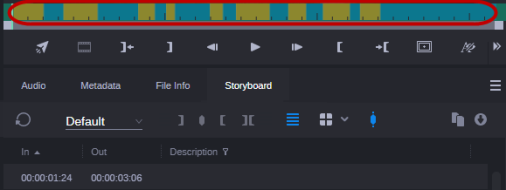

  • If the segments have gaps, the Media Viewer timeline shows the base green timeline color between the alternating orange and blue segments, as shown in the following example.

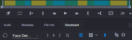

  • If the segments are overlapping — segments that share one or more frames in the stratum — the Media Viewer timeline shows alternating orange and blue sections that represent the individual segments. Overlapping segments are represented by a darker shade of the same color as shown in the following example.
    Each stratum can be configured individually to allow “overlapping segments” — independently from Gaps Allowed and Gaps Not Allowed mode. When such a stratum is selected in the Storyboard tab, gaps are automatically allowed. This means that the “overlapping segments” setting overwrites the “Gaps Not Allowed” configuration mode. You can create any kind of segment sequences in a stratum that allows overlapping segments: Segments can be adjacent, have gaps between them, or they can overlap.
