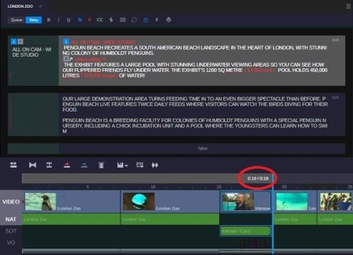

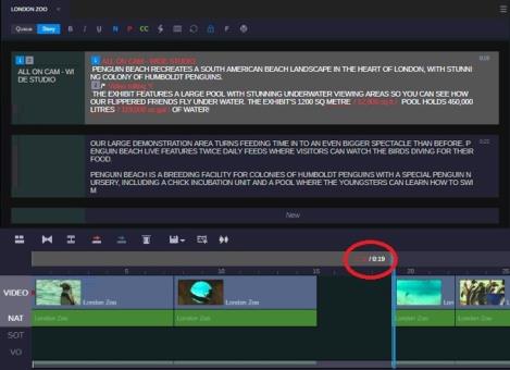

  • In the following illustration, there is no media associated with the story segment, so the timing display is 0:00/0:19. The media duration is red, indicating that more media is needed to match the text duration in the story segment and eliminate any video gaps.
  • If you insert a clip (or clips) that total 15 seconds long, the media fills 15 seconds of the timing block and the timing display changes to 0:15/0:19. Again, the media duration is red, because more media is needed. To fill this 4 second gap, you can lengthen the clip(s) or add another one.

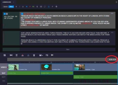

  • If you insert another clip that is 10 seconds long, it extends the timing block. The timing display changes to 0:25/0:19. The media duration is black, indicating that there is enough media to match the length of the text. However, there is now a 6 second gap at the end of the text. You can either trim the video to 19 seconds, or add some text.

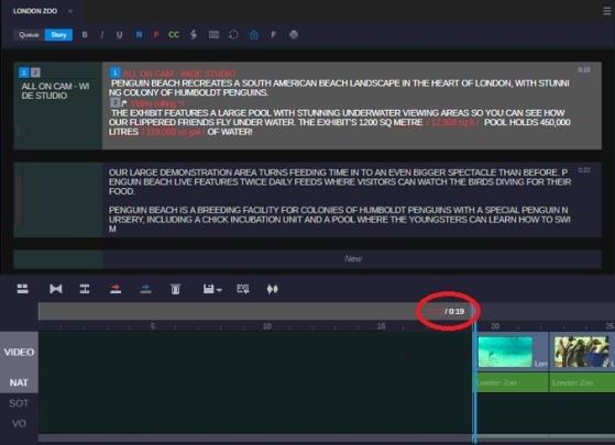

  • If you insert a clip that is 19 seconds long, or you trim a clip to 19 seconds, the text duration and the media duration match. The timing display changes to 0:19/0:19.
