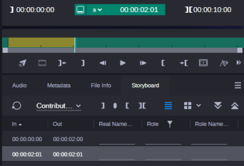

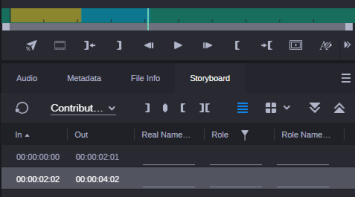

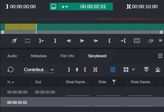

    • Press Ctrl+1 (Windows) or Cmd+1 (macOS), or click Mark In in the Storyboard tab.
      The segment is closed one frame before the current playhead position. A new segment is opened at the current playhead position.
    • Press Ctrl+2 (Windows) or Cmd+2 (macOS), or click the Mark Out button in the Storyboard tab, which closes the segment at the current playhead position.
      Then click the “1 Frame Forward” transport control of the Media Viewer and then press Ctrl+1 (Windows) or Cmd+1 (macOS), or click Mark In in the Storyboard tab. A new segment is opened at the current playhead position.

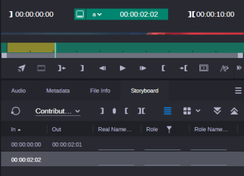

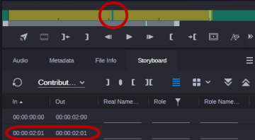

    • Press Ctrl+3 (Windows) or Cmd+3 (macOS), or click the Create Marker button.
      This closes the segment one frame before the current playhead position and creates a new segment with the In point and Out point set to the current playhead position.

    To show a segment created with the Create Marker button you might need to zoom in the timeline.
