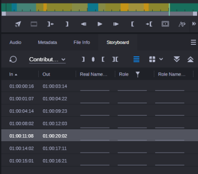

You can create any kind of segment sequences in a stratum that allows overlapping segments: Segments can be adjacent, have gaps between them, or they can overlap. These different sequences can be combined across any section of the video, or across the entire video. The same variety of options is available for the overlapping segments creation procedure. For example, you can create:
  • A segment that overlaps a part of another segment at the beginning or end
  • A segment that is placed within another segment
  • A segment that overlaps a gap
  • A segment that overlaps several segments
The following illustration shows an example for different overlapping segments.

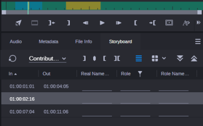

    A segment is created in the segment list with the given In mark but with no Out mark.
    In the following example, the segment was created within the first segment.

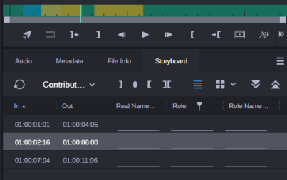

  5. In the Storyboard tab, close the segment by using one of the Create Segment buttons (Mark In, Mark Out, Create Marker) or corresponding shortcuts.
    In the following example, the segment was closed with the Mark Out button in a gap behind the first segment.
