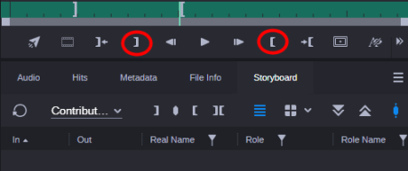

    1. Use the transport controls to move through the video. You might want to pause at the position where you want to start the segment.
    2. Click the Media Viewer Mark In button.
    3. Move through the video; if needed, pause at the position where you want to end the segment.
    4. Click the Media Viewer Mark Out button.

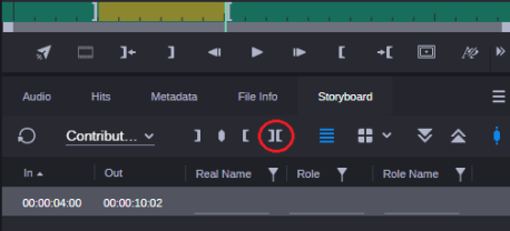

  4. In the Storyboard tab, click the Create Segment button.
    A segment is created in the segment list with the given In and Out mark.
