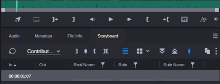

  4. Do one of the following:
    • Press Ctrl+1 (Windows) or Cmd+1 (macOS).
    • In the Storyboard tab, click the Mark In button.
      A segment is opened in the segment list with the given In mark but with no Out mark.

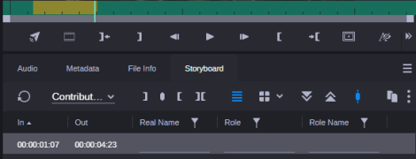

  6. Do one of the following:
    • Press Ctrl+2 (Windows) or Cmd+2 (macOS).
    • In the Storyboard tab, click the Mark Out button.
      The segment is closed at the current frame and the Out timecode is shown in the segment list. The segment is displayed on the timeline.

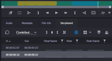

  8. Repeat steps 3 through 6 to create new segments with gaps.
    You can also use the Create Marker button to create a segment where the In point and Out point are set to the same frame.
    The Media Viewer timeline shows the base green timeline color between the alternating orange and blue segments.
