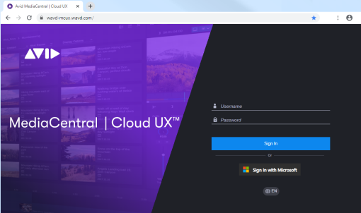

The MediaCentral Cloud UX sign-in page appears. Depending on the setup, you might see different sign-in options.
Example for the sign-in page with the single Microsoft Active Directory sign-on feature enabled.

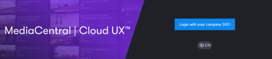

Example for the sign-in page with OpenID multi-factor authentication enabled.

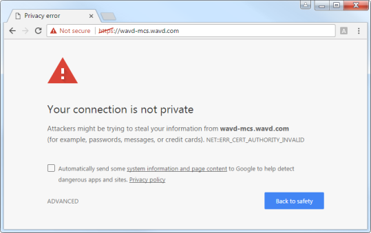

In place of the sign-in screen, you might see a warning indicating that the connection is not private, as in the following illustration.
Example image from Google Chrome.
If you are presented with this or a similar page, it indicates that a security certificate for the MediaCentral Cloud UX server does not exist on your workstation. Contact your system administrator to eliminate this warning message.
c Any attempt to bypass this security warning without a valid signed certificate is unsupported and could result in negative impacts to your MediaCentral Cloud UX experience.

Provide your user credentials or authentication information. Depending on your system configuration, you might have any of the following options:
Provide your MediaCentral Cloud UX user credentials.
Enter your user name and password and click the “Sign In” button to access MediaCentral Cloud UX. If one or more users has signed in before on this workstation, a list of users might appear when you click on the user name field.
If your administrator has enabled the Single Sign-On option in the MediaCentral Cloud UX Configuration Settings app, you might see a Sign In With Microsoft button. If you are working on a Windows workstation, you can click this button to pass your Windows user credentials to MediaCentral Cloud UX.
If your administrator has enabled the Multi-Factor Authentication (MFA), you might need to verify your credentials using a separate authentication system such as Okta.
On the MediaCentral Cloud UX sign-in page, click the "Login with your company SSO" button.
On the Sign In window, enter your user name and password and click the “Sign In” button.
If applicable, verify your identity through any additional prompts that might be generated by your authentication provider.
