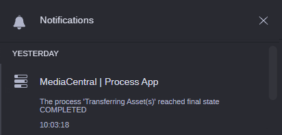

To access your notifications:
  • Click the Notification app button.
    The app appears as an overlay window from the right side of the user interface.
    Notifications appear in order that they were received, with the most recent messages appearing at the top of the list. The right-side of the window includes a vertical scroll bar that you can use to navigate to older notifications. The application retains the last 50 notifications for review.
