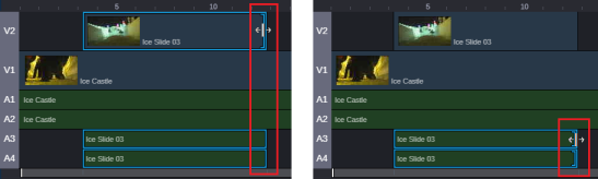

    In the following illustration, the Ice Slide 03 clip has three linked segments (1 video, 2 audio). The illustration on the left shows a simultaneous trim of all three segments. In the illustration on the right, the user is trimming only the audio tracks using the Ctrl+click method.

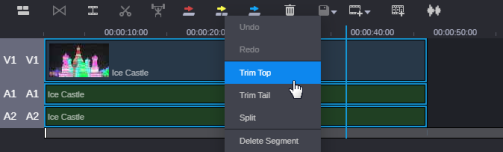

Trimming from the Top or the Tail of a Segment
You can use the current position of the position indicator to trim a segment from the beginning (top or head) or end (tail).
To trim from the beginning or end of a segment:
  1. Move the position indicator to the frame that you want to trim.
  2. Do one of the following to access the Sequence Timeline context menu:
    • Right-click a segment to select it and any linked segments.
    • (Sequences only) Ctrl+click individual segments of a Sequence.
    • Right-click on the Sequence Timline’s timecode bar to trim all overlapping segments at the position of the blue position indicator bar.
    n To deselect a segment, click in an unused part of the timeline.
    • To trim from the beginning of a segment, select Trim Top from the context menu. Alternatively, you can press Shift+[.
    • To trim from the end of a segment, select Trim Tail from the context menu. Alternatively, you can press Shift+].

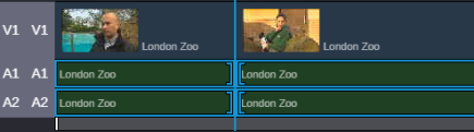

To use dual-roller trim in Sequences:
  1. Ctrl+click adjoining segments in the Sequence Timeline to select them.
    When you select a segment, a blue outline appears around it.
    In the following illustration, the user has selected the segments on tracks A1 and A2 only. If you select segments on one side of a transition only, the operation acts as a single-sided trim.
  2. Hold down the Control key (Windows) or the Command key (macOS) and drag the transition.
    Trim indicators appear on both sides of the transition while you hold down the Control key.

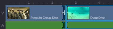

To use dual-roller trim in shotlists and news sequences:
  • Hold down the Control key (Windows) or the Command key (macOS) and drag the transition.
