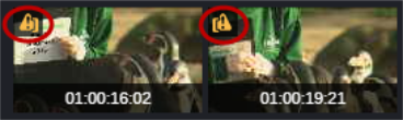

  • A frame with a restriction is indicated by a yellow warning icon in the upper left corner of the thumbnail. An additional In or Out icon indicates if the thumbnail represents the start or the end of the restriction.

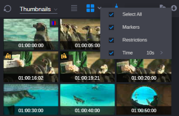

To view and filter thumbnails:
  1. Open an asset in the Asset Editor and click the Storyboard tab.
  2. Select Thumbnails from the layer selector.
    Thumbnails are displayed with timecode for each thumbnail. By default, all marker-based and the 10s time-based options are enabled.
    Production Management marker-based thumbnails show an icon with the corresponding marker color in the upper right corner or a yellow warning icon in the upper left corner or both.
  3. To show only time-based thumbnails, do the following:
    1. Click the drop-down arrow beneath the Card view button and deselect the Select All option.
    2. Hover the mouse over the Time option and in the menu that opens select the frequency you want to apply (10s, 1m, 5m, 10m).
      The selected frequency is applied to the thumbnails display in the Storyboard tab and the selected option is shown beneath the “Time” option in the menu.
    3. Click outside the menu.
  4. To show only marker-based thumbnails, do the following:
    2. Select the check box of the marker-based option you want to apply. Multi-selection is supported.
      The selected option is applied to the thumbnails display in the Storyboard tab.
  5. To show marker- and time-based thumbnails at the same time, click the drop-down arrow beneath the Card view button and select the Select All option.
    The selected marker-based and the selected (or default) time-based filter are applied to the thumbnails.
