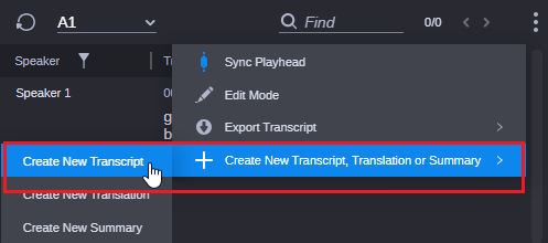

  3. Click the Create New Transcript, Translation or Summary button in the Transcript tab toolbar and then select Create New Transcript.
    If the button is not shown, click the More Options button and select Create New Transcript, Translation or Summary > Create New Transcript from the menu.
