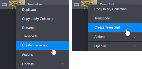

  2. Do one of the following:
    • Select a master clip or subclip, then click the App Menu and select the Create Transcript menu option.
    • Right-click a master clip or subclip and select Create Transcript from the context menu.
      The context menu for a master clip in the Browse app (left) and Search app (right)
    The Create Transcript dialog box opens. For a subclip, the dialog box shows the warning that the whole master clip will be transcribed, not only the subclip.
