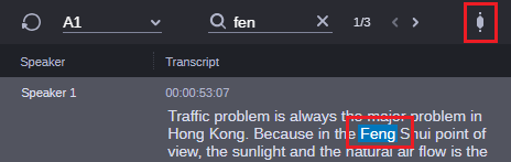

    All words in the transcript that contain your search term are highlighted in blue. The transcript scrolls down to the segment with the first matching word, and selects the word.

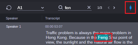

    • If Sync Playhead is enabled, the word is highlighted in green. In this case, also the playhead is moved to the corresponding position in the timeline.
    • If Sync Playhead is disabled, the word in still highlighted in blue. In this case, the playhead is not moved in the timeline.
