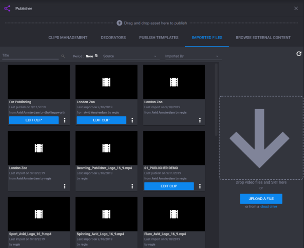

Once accessed, the Publisher app opens to an initial interface with five tabs appearing below the Publisher app header (Clips Management, Decorators, Publish Templates, Imported Files, and Browse External Content) as shown in the following screen example:
The five tabs are described in the table below.

4
Imported Files
Shows files that have been submitted from Avid bins to the Publisher app for publication to social media. This tab also includes filter and search criteria that can help you locate imported video clips.
For more information, see Adding Content to the Publisher App.
