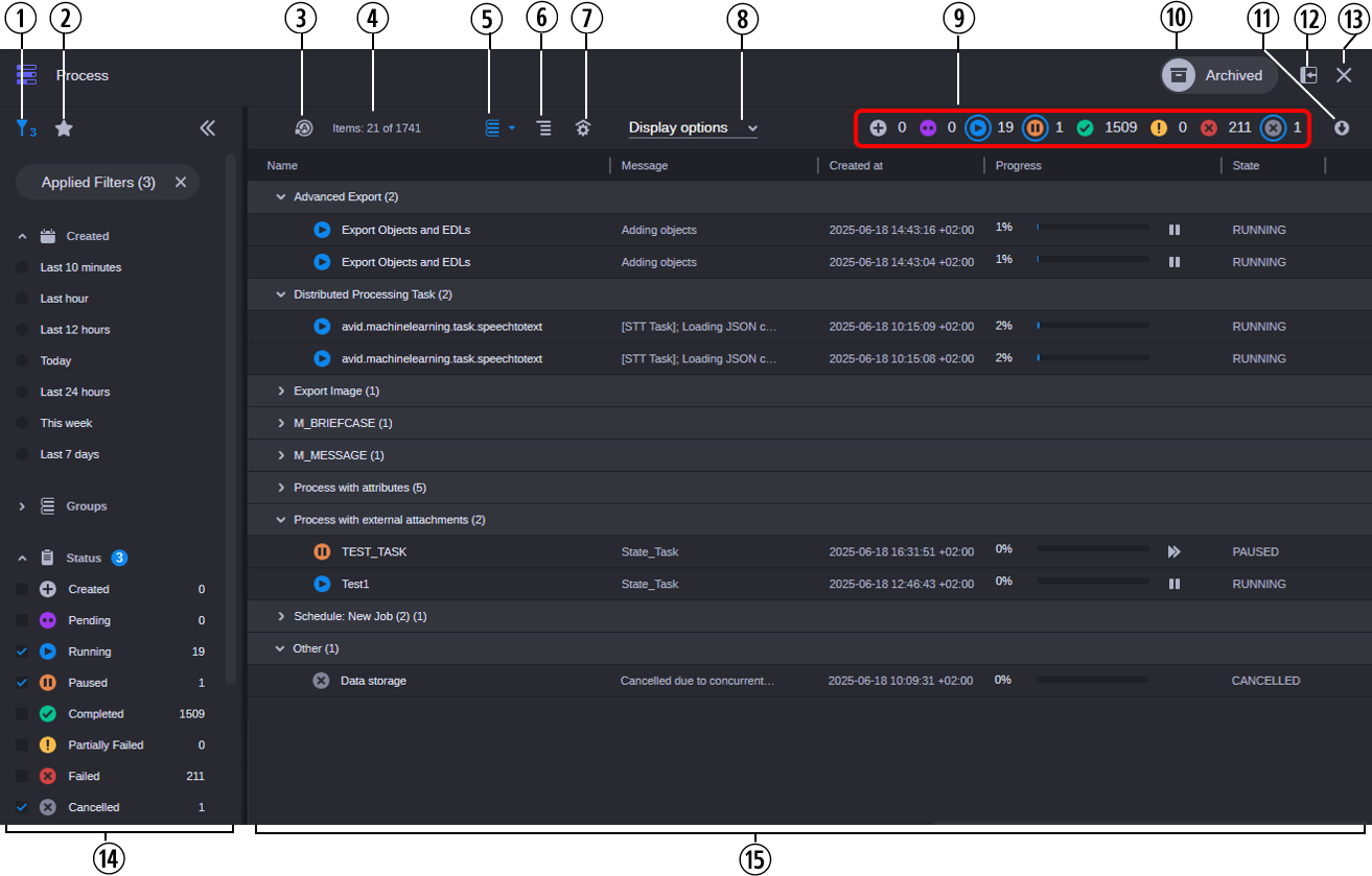

In the Process app, you can monitor the processes of the selected type, apply filters to the processes displayed in the Process List, and modify the Process List layout. The following illustration shows an example of what you might encounter when monitoring processes in the Process app if the option to display processes in groups is active.
Display or Control
Filter button
Opens the Process sidebar's Filter tab that lets you apply predefined filters to the processes displayed in the Process List. See Showing and Hiding the Process Sidebar and Applying Filters from the Process Sidebar.
Favorites button
Opens the Process sidebar's Favorites tab that lets you create and apply process favorites. See Showing and Hiding the Process Sidebar and Creating and Using Process Favorites.
Refresh button
Lets you enable and disable an auto-refresh of the processes shown in the Process List. If enabled, the Auto-Refresh option updates your processes list every five seconds. See Refreshing the Process List.
Process counter
Displays information about the number of processes shown in the Process app: Number of displayed processes in the form “Items: <n> of <m>” (for example: Items: 100 of 580). <n> is the number of processes displayed in the Process List, <m> is the number of all processes that match the applied filters.
The numbers are influenced by applied filters and Grouping and Hierarchy toggles.
Items 0 of <m> is shown when you enable grouping since the collapsed process groups are shown in the Process List.
Display Group button
Toggles displaying processes in groups on and off:
  • If toggled on, processes are displayed in the Process List grouped by the process group property (or by the process class property, if process group is not set).
  • If toggled off, processes are displayed in a flat list.
When displaying processes in groups is toggled on, you can show and hide the contents of the process groups. See Working with Process Groups.
Show Hierarchy button
Toggles displaying the process hierarchy (parent processes with their child processes) on and off:
  • If toggled on, child processes are displayed below their parent process in the Process List. The child processes can be shown or hidden.
  • If toggled off, all processes are displayed in a flat list.
When displaying processes in hierarchy is toggled on, you can show and hide the child processes. See Working with the Process Hierarchy.
Top-level Filter button
Toggles displaying top-level processes on and off:
  • If toggled on, only top-level processes are displayed in the Process List.
  • If toggled off, processes of all hierarchy levels are shown in the Process List.
8
Display Options
Lets you define which columns are displayed in the Process app. See Showing and Hiding Columns.
9
Status icons
Shows an icon for each process state. Lets you apply a filter to the processes that are already shown in the Process List. To the right side of each icon the number of processes being in the corresponding life-cycle status is shown. See Applying Filters from the Toolbar.
10
Archived toggle button
Toggles displaying active or archived processes:
  • If toggled on, only archived processes are displayed in the Process List.
  • If toggled off, only active processes or recently completed processes are shown in the Process List.
The Archived toggle button is only visible for administrators and members of a group with enabled Master of Jobs entitlement. See Viewing Archived Processes.
11
Download button
Downloads the list of processes that match the current filter criteria in a *.csv file. See Downloading the Processes List.
12
Docking button
Docks the Process app at the left side of the MediaCentral Cloud UX window.
13
Close button
Closes the Process app.
14
Sidebar: Filter tab
The controls of the sidebar's Filter tab apply filters to the processes that are already shown in the Process List. See Applying Filters from the Process Sidebar.
Creation Time filter
Filters the processes shown in the Process List by creation time. The Creation Time list offers relative time ranges.
Groups filter
Filters the processes shown in the Process List by the process group property.
Status filter
Filters the processes shown in the Process List by life cycle states.
System filter
Filters the processes shown in the Process List by the system on which they have been created. The filter shows only systems that support the System filter and on which processes are being processed. The System filter includes the option to filter for Media Analytics Engine jobs (Media Analytics), actions triggered by platform automation rules and scheduled jobs (Automation), and transfer jobs triggered by the Platform Storage Connectors (Storage). An Unknown option lets you filter for processes of the connected systems that do not support the System filter.
Creator filter
Filters the processes shown in the Process List by the user who initiated the process. The filter is only visible for administrators and members of a group with enabled Master of Jobs entitlement.
<custom property filters>
Up to 25 custom properties can be configured to show up as filter options in the Process sidebar. If the custom property is empty for all existing jobs, it will not be shown as filter option.
15
Process List
Displays processes, depending on the filter applied to the app. The Process List shows the following columns by default:
  • Name: Displays the name or the ID of the process. In front of the process name an icon indicates the life-cycle status of the process.
    The icons change as soon as the life-cycle status of the process is changed.
  • Message: Displays a message depending on the provider of the process; for example, a message if an error occurs during the process life-cycle or information about the current process status of an Asset Management process. Might be empty.
    If the message cannot be completely displayed, the text ends in an ellipsis. You can enlarge the Message column width to show more text. When you hover the mouse pointer over the Message column, a tool-tip also shows the message. Large messages might not be shown completely in the tool-tip because of Chrome browser limitations (1024 characters).
  • Created at: Displays the date and time when the process was created.
  • Progress: Displays the progress of the process life-cycle as a colored bar and percentage value.
    • Uncolored bar and percentage value 0 for Pending processes.
    • Blue bar and percentage value 0 through 99 for Running processes.
    • Green bar and percentage value 100 for Finished processes.
    • Red bar and value 0 through 100 for Failed processes.
    To the right of the progress bar, the following buttons to apply actions to a process might be shown:
    • Cancel: Cancels the process underway. The Cancel button is shown for active processes that allow cancellation and for failed platform automation actions.
    • Retry: Retries a failed or canceled process (Production Management processes) or failed platform automation action.
    • Scheduled Retry: Indicates that a retry is scheduled for a failed platform automation action.
    • Pause: Pauses an active process (status: Created, Pending, Running)
    • Resume: Resumes processing of a paused process.
    See Canceling, Retrying, Pausing and Resuming Processes.
  • State: Displays the status of the process: CREATED, PENDING, RUNNING, PAUSED, COMPLETED, PARTIAL, FAILED, CANCELLED.
You can configure which columns are displayed by using the Display Options menu. See Showing and Hiding Columns.
(Administrators) Right-clicking a process in the Process List opens the Delete job context-menu that lets you delete the selected process. See Deleting Processes.
